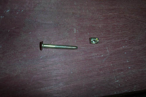

Hi Michael, with your permission while you guys are on the threaded rods and inserts topic, i have a small question if i may? In the photo below, there are rods and inserts i got out of something, 8 of them rods 2" long and the inserts are 3/16" if my memory serves me well and thought i would have enough for 4 guitars. Are these good for guitar buiding or should i buy something else? TIA,Sorry if disturbing!
Here it is

Serge--looks like a barrel bolt to me. Should work.

The only conserns I have is the 3/16 vs 1/4 is what I use and the lenght of the bolt may be too long therfore the threads may end too far away from the head if cut down to required length ie the nut nay try to ingage the un-threaded shank, this is of course subject to the depth of your heal. I don't use barrel nuts but I if I did I would want to place ny barrel nut un the middle shallowest depth of the heal to have equal heal material around it. not that the far side matters much since the nut forces are in compression and never in torsion.MichaelP38735.5831828704

Serge, thats looks like an off center barrel bolt. You really want to get the barrel bolts with the threaded hole in the center, that will give more wood area and strength to the tenon. Check out Cumpianos site for info on this joint. I ordered a lifetime supply of the barrel bolts several years ago and forgot the source.
A 10mm drill bit is also handy as the barrels are 10mm.

Serge, You really need the barrel to be the width of your tenon or just slightly less. 3/4" in my case.
I tap 6 mm. holes in 3/8 brass rod and cut to length. A 1" deep tenon and the barrel placed right up against the heel. I also seal the hole ( prior to inserting the barrel ) with thin C.A. I think a big advantage with the barrel system ( Cumpiano method ) is that the barrel can rotate to suit any neck angle.
